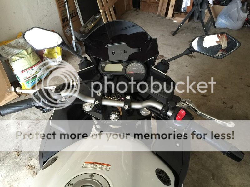

As far as the woodcraft bars go - has anybody added any longer grips? I'm not satisfied with how the bars look because of the small size of the stock grips for the throttle and left side, also how about bar ends? Any good recommendations for either part? Thanks in advance!

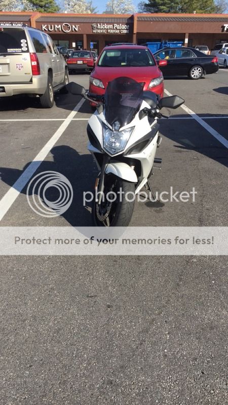

Before:
After

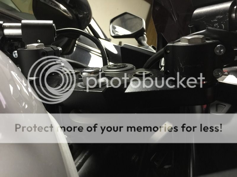

Side shot of the clip ons (don't mind the nicks)
And side shot, not sure if you can tell how much lower the bike is now, but it's certainly a good deal lower

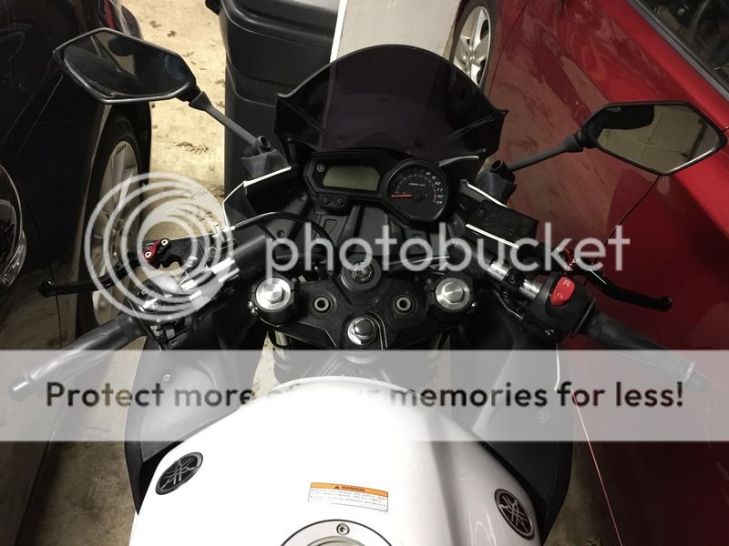

I agree. Have same bars and that would probably be awkward. Wonder why the throttle grip is up so far on the bar.It looks to me like your entire right assembly is too close to the mount. I would suggest moving the assembly down the bar so your grips line up with the end of the bar and only the bar end sticks out. I would think having the two grips mounted differently would cause handling problems.

I don't think I did anything to my cables. Maybe there's slack being held by a zip tie or something. Mine is much closer to the end of bar. I didn't change cables or anything. Might have finessed them a bit. Just put the Kuryakyn grips and throttle control bar ends on. Wow, much more comfy grip. Just need to let the hairspray dry good. Hoping it holds, didn't want to use the glue that comesee with them ,because it sets super fast and is permanent until you pry them off somehow. Hairspray worked well for my spider grips.I can't slide it down further, I feel like the wires and cables are taught and don't have my slack to slide further down.. am I missing something to do with the wires/cables?

I can get a pic tomorrow after work. I never changed my kick stand and have had no issues. Does stand pretty upright,but plenty stable.I checked around, tried re-routing some cables and viola I was able to get just enough slack to shift it further down

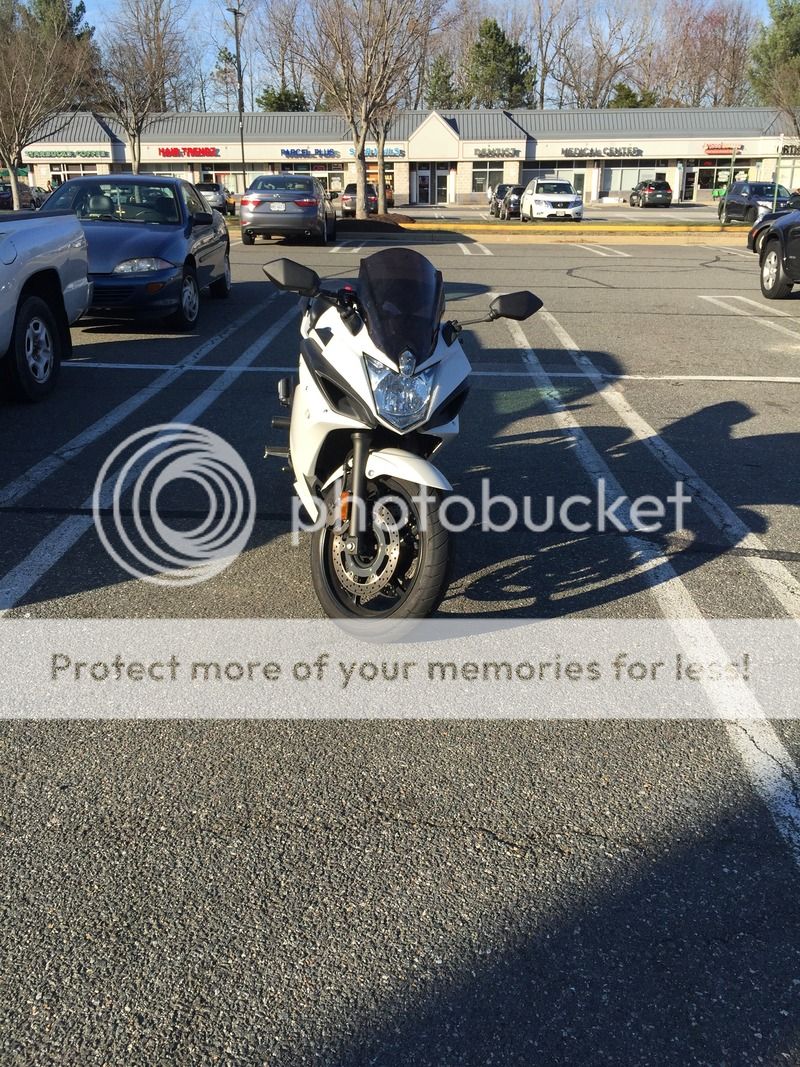

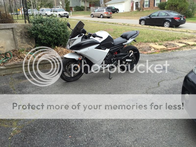

See for yourself, two quick pit stops
Not as drastic a lean as prior to lowering.

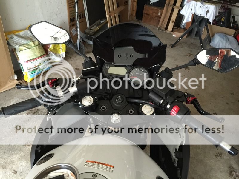

Here are some pics I just snapped.Much appreciated! I'll keep an eye out, I do have to say your bike is the reason I went with the mod (and my accident last summer)!
