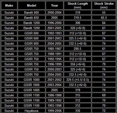

Just swapped out my Bandit shock for a 06 Hayabusa shock. AMAZING difference. Full rebound, compression, preload settings. Feels like a completely different bike.
I am at 36mm sag now. :thumbup: Still need to do something with the front, but I am at 40mm sag there so its not too bad.
Suspension should be everyones first upgrade. Seriously, it transforms the bike having a proper setup. Crazy how much different it feels. Feels glued to the road. Being how great if feels now, I would love to feel a full on aftermarket upgrade!
Best upgrade I think I've ever done. And all for $35 shipped to my door. :cool:

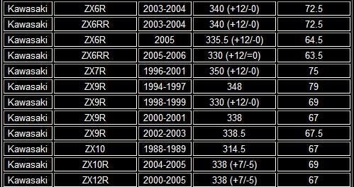

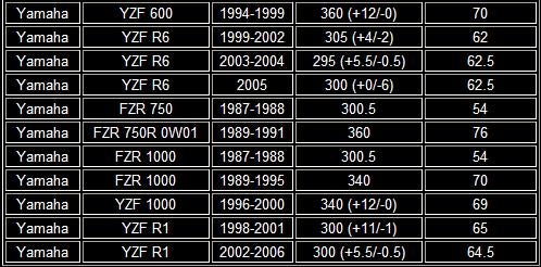

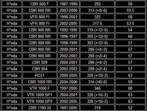

Makes me wonder how hard it would be to swap the shock on the FZ6R to an R6!
Just need to check the overall length of the shock, and the spring weights. Curious about that myself. On the Bandit site, they have a list of all the different shocks that could be compatible, etc.
The Hayabusa shock is a tad longer so it raises the rear of the bike up a little bit. Not much though.
Looks like the 99-01 Rear shock for R6 is around300mm. If you are close to that, it may work. But if the R6 spring is softer, you wont want it. Being it is a lighter bike, who knows... Luckily this was all figured out for me and was an easy swap haha.
