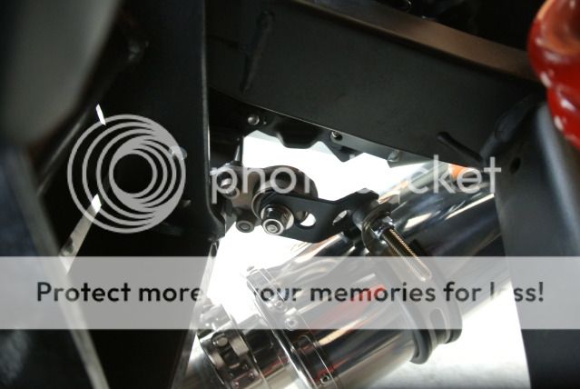

only thing I did was make a bracket for the exhaust hanger that came with the slip on which is definitely not needed but I like the reassurance plus my way to school has awful bumps and I just didn't want to risk it.

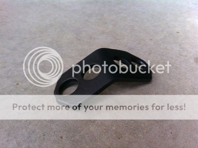

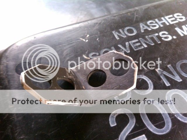

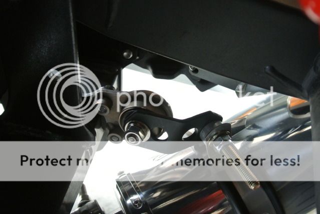

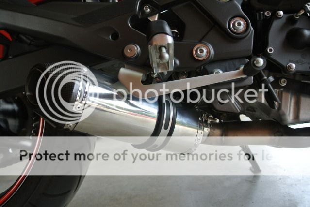

as you guys wanted i took some pics of my bracket i made, totally not needed but the exhaust doesnt wiggle a bit so its sturdy for my bumpy roads, videos will have to wait until tomorrow, I have been working on videos of my truck yesterday and today.
parts i used were:
5/16" by 1.25 or 1.5" long bolt and nut(stainless)
2 regular washers(stainless)
1 lock washer(stainless)
and a piece of aluminum(no rust)
here is the piece i used, rounded the corners a bit and shot it with a nice coat of matte black spray paint to make it look nice.

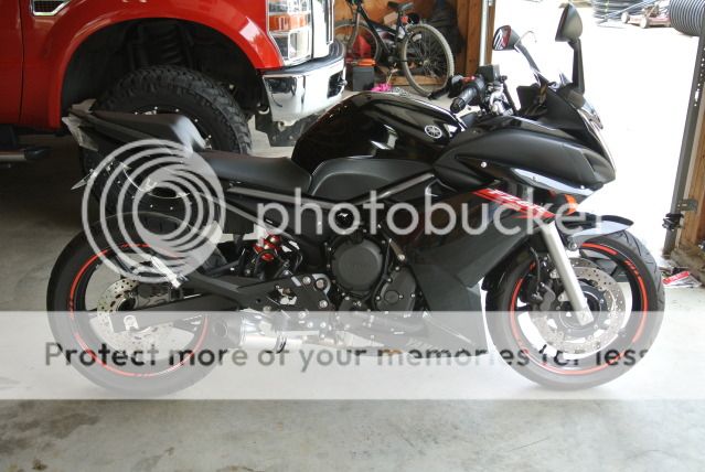

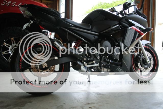

Thank you, sounds amazing too. I got it completely stock a couple weeks ago and this is what it looks like now. Only thing i still want to do is get flush mounts if I could somehow figure out a way for another signal to be seen from the front of the bike, the mirrors don't bother me too bad, they are actually quite nice unlike previous bikes that you can't see around your self.

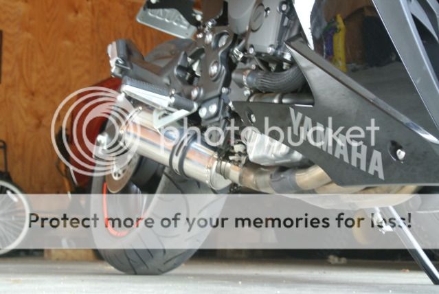

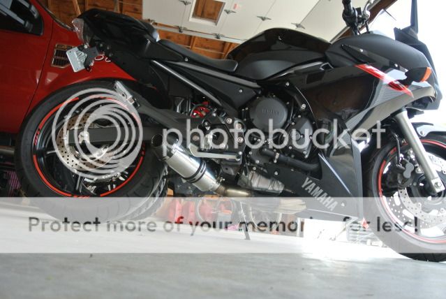

Did you make the bracket yourself? I saw the post pics and the end result looks great. Also where did you get the exhaust clamp (the one actually on the muffler)?
yes i did make the bracket my self, its pretty easy just a piece of aluminum and bent it to the angle that fit best and bolted it up. The bracket that goes around the muffler is included from viper that you will get from marthy!
