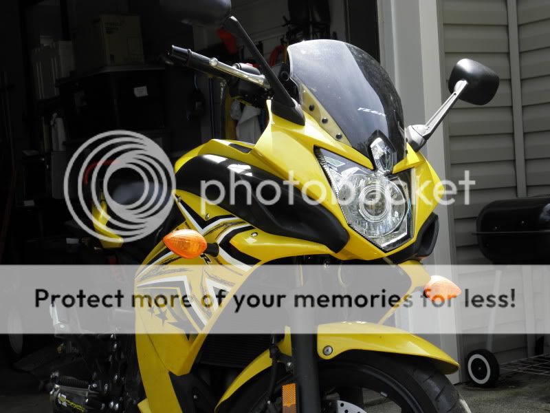

I guess it would be nice to have a company make them, but you can do it yourself for half the price. If you go in halfsies with someone on a car kit, you split the price and it comes out to be half of what Nate has quoted you.
The installation is really simple. I know I never got around to doing a full how-to detailed with pictures, but I could get a summary written up and posted in the other thread if guys are interested.
MikeN02
Have them on my R6 with the Angel Eye CCFL halos. Popular mod to do nowadays when you upgrade your headlights.
They produce the same if not better light output then just sticking HID bulbs in because with the projector you are aiming/focusing the headlight, so it isn't scattered everywhere with the reflectors.
A note for installing something IN the headlights is to bake the headlight in the oven (yes I know sounds odd). But you can't get it off without heat because the headlight is sealed shut.
Heat melts the glue/silicone a little and then you can pull it apart easily. After you're done then throw it back in the oven and seal it back together (you never really lose any glue/silicone).
Just don't try to use a heatgun to open it, I've heard it could melt the plastic housing.
When I opened my headlight I put it to about 200F for about 12 minutes.
