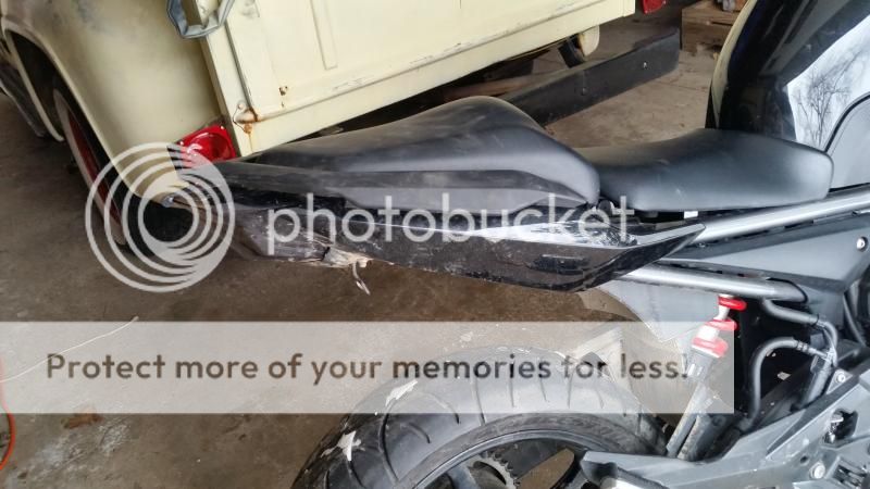

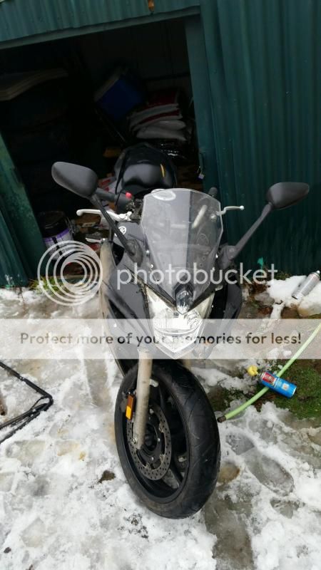

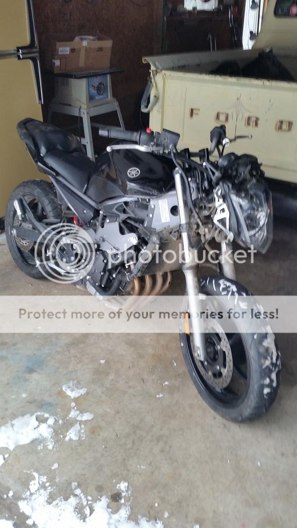

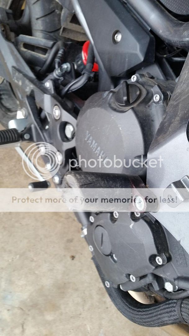

So, I picked up an 09 Fz6r that had been laid down at some point. I got her home and realized that the damage isn't too bad. Luckily the PO had frame sliders so the engine suffered no damage. The plastics were off when i got her but they're trashed and also I'm missing the front fender.
The biggest issue is the left fork slider is cracked in half. I can't tell if the fork tube is bent as well but I have to imagine that it probably is.
At any rate, I plan to keep the fairing off, relocate the headlight and run her naked. (new plastic is just too expensive) She has a rebuilt title that needs to be inspected so i'm putting on new blinkers, mirrors and bars. Oh, also the passenger peg mount is broken.
