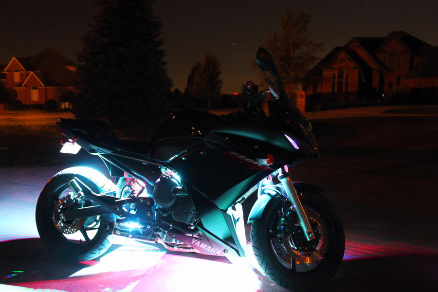

Just wondering if Sage (if you read this) tell me where you mounted your lights, what LED did you use?, how did you mounted them? (tape/glue), and how did you setup the wiring?.
My plan is to run 6, white LED strips (pic attached below) around the bike but would be hand to know what spots to place them to get it lit up similar to what you have done.
Since the LEDs draw bugger all power, I will have them wired straight to a switch on the dash with a small fuse after I work out current draw.
I also have red LED strips that I will wire in with the brake light and attach these under the rear guard for some nice brake light at night.
Cheers

I used some waterproof audio led tubes that our local audio outfitter had. Here is a vid of the placement.
https://www.youtube.com/watch?v=DmhxVp6Gjco

Keep in mind when adding in these types of LEDs that they are rated for 12V systems not the typical 13.7V that a bike can run up to. So that means that they will be getting too much voltage which will reduce their life span. You should add in a resistor based on what each strip will need to further reduce the power from the bikes system.
If you don't reduce the power they will burn out within a 6 months to 2 years.
Placement is key as well, don't place them near hot areas as that will contribute to them burning out.
I scored a 10 meter roll for $5 so if they do manage to burn out in say 6-12 months, I am not too fussed. Gives me another excuse to pull the bike apart and clean.
I plan on running them off the battery (constant power), up to a switch on the dash somewhere so 12v is no worries. I don't plan on using them while in motion. The only ones I will have on with the bike running are the ones I stick in the fake air scoops but these will be tapped into the park light globe circuit.

Well, here is a couple problems with that. While the bike is running the bike is charging the battery it will getting 13.5-13.7V of power. While the bike is off the battery doesn't put out just 12V of power. It actually typically puts out 12.6-12.85V. So you will still be running them at a higher voltage than they should be getting. A simple resistor placed inline will reduce the voltage and allow them to still be bright while not heating up too much and burning out.
Also once you establish what resistor you need then you can simply just wire it in. If you link me to the LEDs you ordered I may be able to figure it out for you but likely I would need you to ship me a small section of the LEDs so I can hook it up to my meters and test the Voltage and amperage at 12V and then calculate the right resistor. Though typically the lights will just be standard 2V at 20mA run in sets of 3 so if they are using a 330ohm resistor you can easily just add a 180 ohm 1/4 watt resistor in leads that you will have to solder onto the sections you cut. That should be enough to reduce the power to safe levels. You can order a bunch of them off ebay for a few bucks but sometimes the strips will have sections that you can actually solder in a secondary SM Resistor before you solder on the lead wire that you will need to install.
If you look through the clear gel that they have on the top of the LEDs you will see the small black Surface Mount Tech. It should be marked "331" if it is that's a 330ohm resistor. Though a lot of the cheaper resistors are not marked..... then you just need to sacrifice one small strip section and strip the gel off and hook a meter up to it to test the resistance.
If you are going to take the time to the job, you should do it right.
3 x 5050 LED with 3 x 331's per strip.
I have 2 long strips in my Ute (pickup?) and they have been working for a couple of years and are used quite frequently. Still no issues and work brilliant.
The link to the red lights I bought is here: RED LED
The white LED's I bought quite a while ago and are the same. I have cut these in to smaller strips for use on the bike. Pic was in my previous post.
