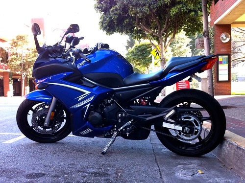

Here is the after photo:
Nice! Glad to see they are using them! Thanks for the post. So... did they give me any credit for the instructions?
It's a great product!
