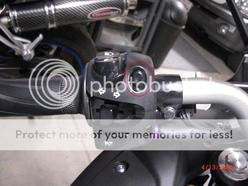

Here's pic...
Yone
Here's pic...
Is that the dummy button, or the one you added for the garage door opener?
I would like to wire up a button for my garage door as well, but have NO idea where to get a button and how to do it, besides wiring into the actual door opener remote and mounting it to the bike somewhere...

That dummy button is for Countries like Australia, that require a "passing" light by law.....you hit it, and both, high and low beam come on together on Australian spec FZ's.....
The black button is just the dummy plug that comes on the bike. I shaved down the back of it to fit the switch button behind it. The wires from the switch are run to the garage remote (key chain size for me) that is mounted under the dash.
The switch I got from Radio Shack. It's a very small, red topped push button. The head of it fits right into the hollow of the black "plug".

So the FZ6R has no hazard button? I thought you had to have that, as useless as it is.
xplodnstar
Not all states/countries require it. Yamaha still uses the same housing, though, so the black button they put in is just to fill space.

The FZ6 and FZ1 have a functional hazard button. I might just disconnect the hazards and wire mine to the door opener.
On Michele's FZ6R, I'll go buy a switch and do what xplodnstar did. :D
