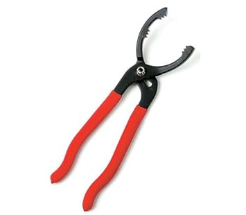

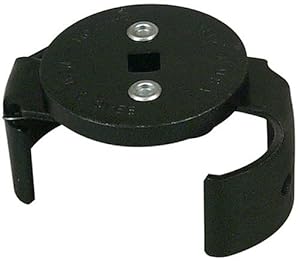

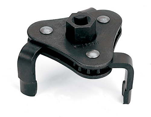

What I use at my job is a combination of a filter clamp and filter pliers depending on the location and clearances. I prefer the clamp but the pliers work flawlessly too. Also make sure you put a thin layer of motor oil (or silicone grease since I find it works better) on the Oring before you put on the new one and only hand tighten the filter as much as possible. You cant over tighten by hand while if you use a tool to install itll be like this to get off.
Heres a few pics of what I use. I recommend the 2 half circle clamp like this one and not the 3 finger one in the third image. Coworkers have the 3 finger one and always borrow mine :D
Avoid this one since it doesnt clamp down on the filter to prevent slippage as the other style
