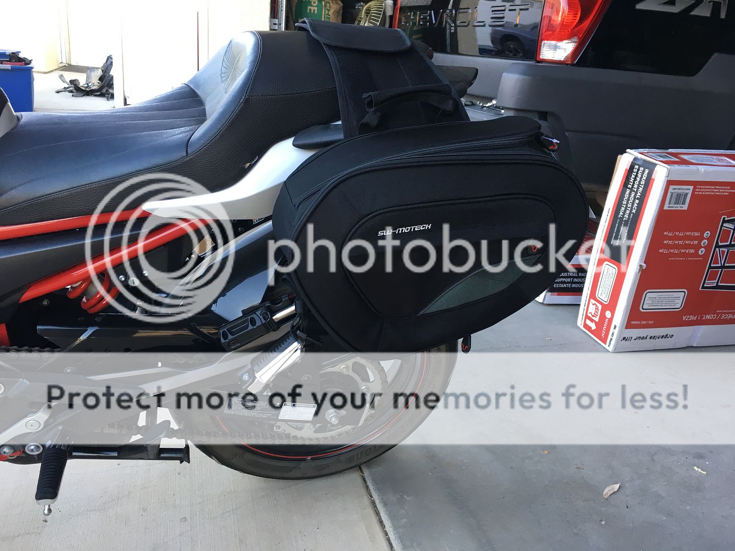

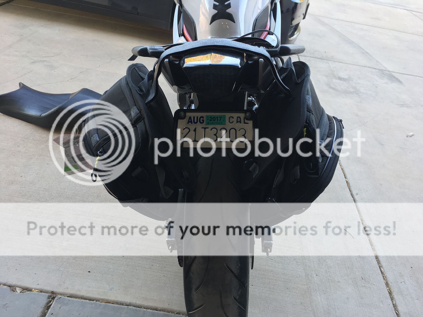

Alright so I received both the Givi and SW side bags tonight. Here's my opinions on both.
Quality - Right off the bat, the Givi bags appear to be of better quality. They just seem better made and they have reflective piping sewn around the sides and it definitely stands out. They just feel like a more thought out bag. The SW's are definitely no slouch they feel like great bags. But they aren't as well thought out or draw the eye as much. Which could be a good thing depending on your perspective.

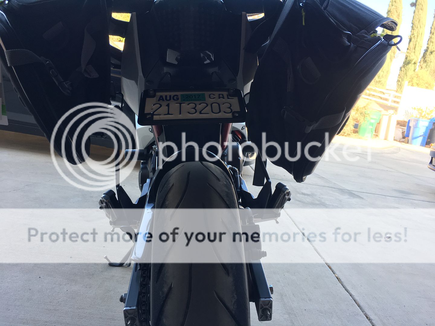

Fitment - This is where the Givi's fall short, I cannot for the life of me find something solid to attach the 2 bungee cords they included to the frame to keep them from swinging into the tire when loaded. The instructions included with them are downright awful, they don't suggest at all how to keep them stable and even suggest mounting them with their metal bracket designed for their hard cases. I've tried changing the height and tension on the top straps dozens of times trying to find a position that works the best, now granted I could be having issues with this due to me keeping the rear brackets but the whole reason I'm going with side cases is for cost and convenience. I strap stuff down to the back seat all the time as needed and don't want to remove those brackets. All in all it looks like these may be out as I cannot keep the bottoms of the bags from possibly touching the tire. Which is unfortunate as they were a great price.
The SW's on the other hand excel in this category. The brackets they include are very well thought out and built solid. The brackets for the lower pipes install attached to the rear foot peg. Once initially installed they quickly clip in or out in seconds. And provide solid support locations for the bottoms of the bags. It takes no more than 5-10 seconds to install these bags on the bike. My only complaint is that I cannot get the upper strap under my seat. It may be my Corbin seat is that different from the factory rear or that these just weren't designed to be installed like that. In which case this would be a moot point. The instructions included with these are much clearer, detailing each step necessary to install them well.

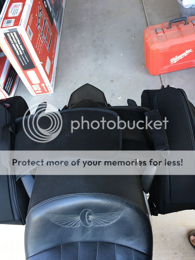

Security - This is where I'm concerned, the Givi's I can get installed with the straps under my seat but I can't comfortably attach these in a way that will keep them out of the range of my rear tire, so at this point these bags a complete no go. The SW's on the other hand fit great, my only complaint being that I can't get the strap installed under the seat so it would only take someone seconds to walk up, unclip the two clips that attach them to frame and just walk away with them. What's the best way to lock soft bags to your bike? If there's really any?
Sizing - I was considering the Givi EA100 side bags for the increase size, my god am I glad I didn't. Those things would have been huge hanging off the FZ. The SW's are comparably to the 101's, I think I'lll be able to squeeze almost as much in the SW's. Obviously slightly less but I'll take that tradeoff for the fitment.
Durability - The Givi tank bag I have I've only had for one season so I can't attest too much to their durability, but it has held up fantastically so far and shows almost no wear. I do not own any SW products however so I can't personally attest to how well these will, but judging by looks and feel they seem to be very well made.

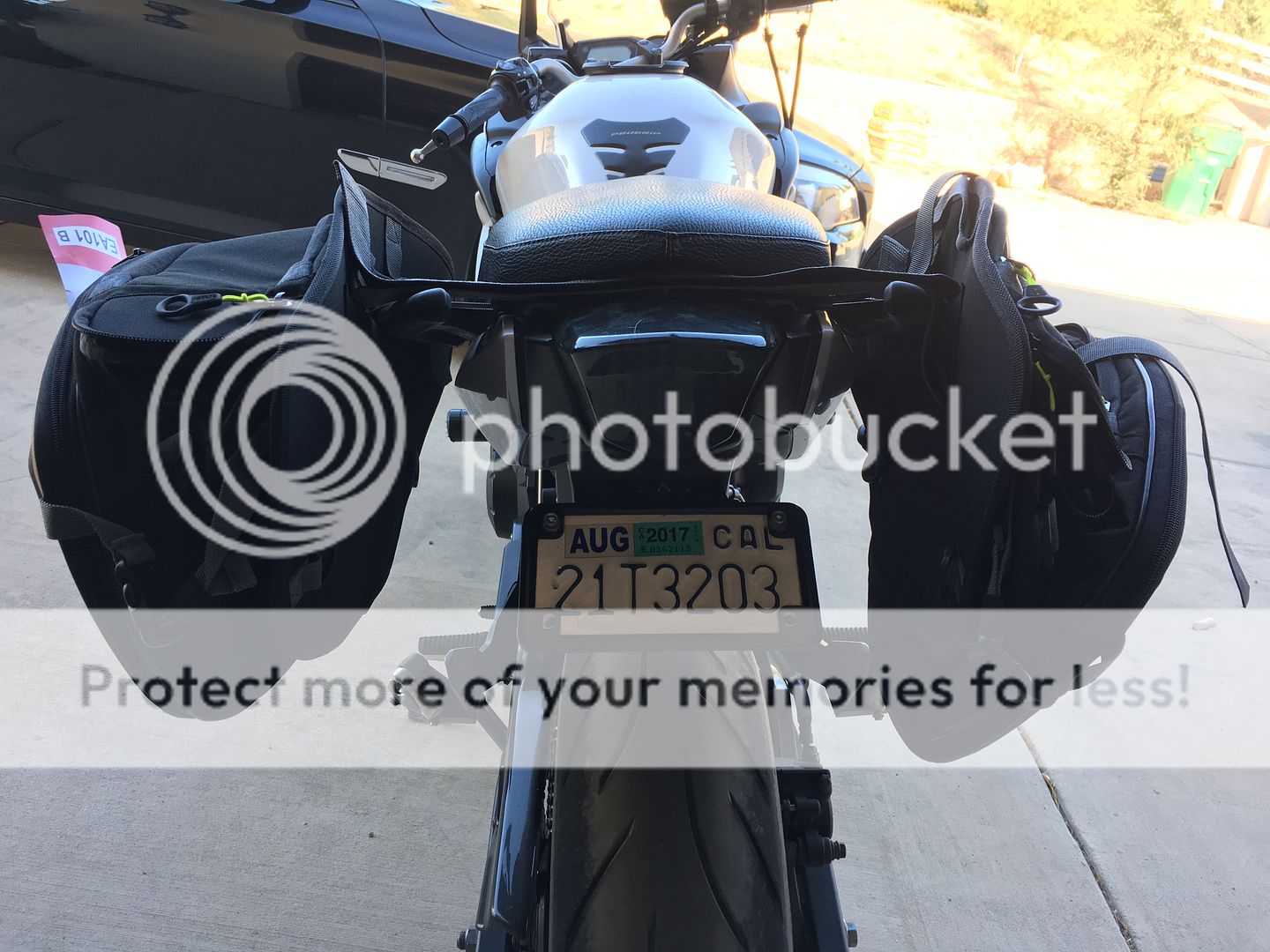

First pics will be the Givi's, followed by the SW's
This shows the first position I tried, I tightened the tops as much as I could to keep the bottoms out of the way of the tire.
And this one is loosened so they drop to about the range that the SW's mounted at.

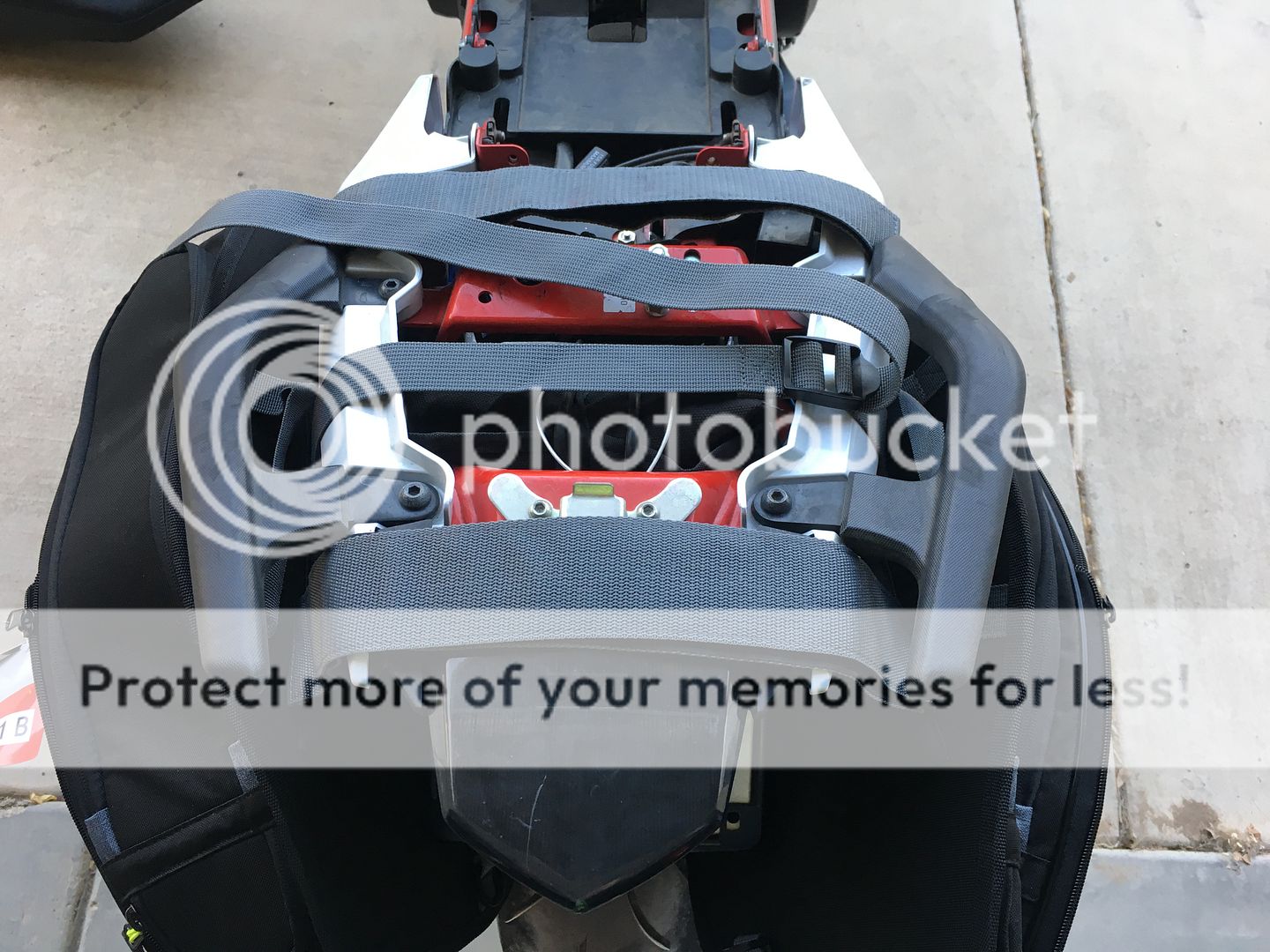

This is how the strap ran under the seat.
And once I had the bungee cords installed in the best way I could find, this is how the right bag reacted to being loaded with weight.
This show however, shows how well the SW's mount to the bike.
The only problem here with the SW's is, well for one cost (they're 3 times the cost of the Givi's), and the fact that the strap runs on top of the rear seat. If anyone here has some solid suggestions on how to lock these bags to the bike so someone can't just walk away with them when I'm grabbing a bite or something on the road??

It isn't possible to run the velcro straps under the seat?
If it's a little too wide, maybe trim it where the latch goes?
Or perhaps cut the velcro straps and fabricate a custom way to attach (or velcro) to the structure under the seat?
I'm sure you probably could, but for what these costed I didn't want to cut them up at all to make them fit. After doing some more digging I found out I could get a pair of Gigi quick release sidecase brackets and a pair e22n hardcases for only ~$60 more than I paid for these soft cases. So I got the Motechs boxed back up to head out. Still debating buying the luggage though.
