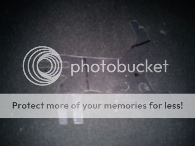

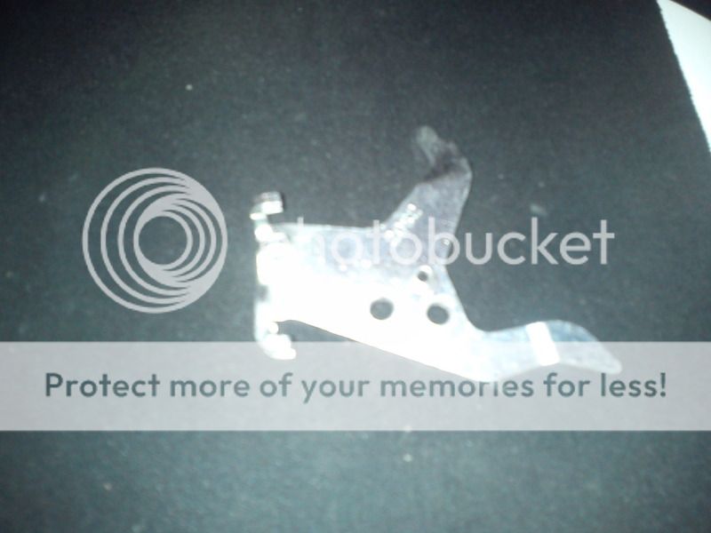

don't know if any one has said this but the after market bracket @ $140 is a bit rude. I knocked mine up in 30 mins and cost 5 bucks
I have just been playing with mine the 2 screws have thread sealer loctite in there if you break them you will haft to ezy out them which could be risky as there is not much around the thread best way to loosen the thread warm it with a heat gun but make sure you don't damage any thing on the throttle body warming up the area will loosen the loctite. they undo anti clock wise just in case you didn't know if you not sure take it to someone who can do it for you as damaging the tb will cost you dearly
$140 is a tad rude, if I may ask, how did you knock yours up for $5? Thanks in advance.
went to mitre 10 got 2 pieces of 150mm x 3mm x 50mm plate cost me $1.85 (only really need 1 but got 2 just in case i stuffed up) got a cutting disc for my grinder $1 made a cardboard template from my original bracket. traced it on to the 3mm and cut to shape took about 30 mins stuck it on easy as i also took of my tank and filter to confirm it was indeed getting full throttle looking at the res art 1 if thats how they come they need cutting the stop a fair bit more all i did was put it in to a vice at the black line and bent it easy as you also dont need the the top piece
took it out when finished i gave it a full throttle run my god theses things honk!!! jeppers
my original braket
a plastic template
