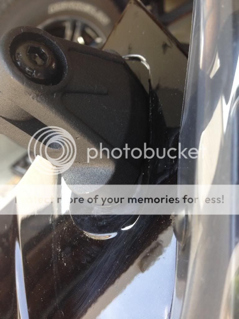

ok, so test fitting projector and shroud i found out that the shroud was very close to the housing so i did a little trimming for clearance(after having the light on the bike i found out after adjustment the shroud is still very close to the housing so i would make sure you have a 3/16" gap if you go with these over size shrouds. i had about an 1/8" gap)

Looks good! The trimming of the shrouds is a fine art, since you have to make sure that the projector is aimed high enough. You removed the reflector bowl so you could paint right? When I receive a headlight, I tape off the halogen beam pattern, so when I am done, I can re-aim the projector beam based on that original height.

i was able to park the bike 25feet away from the garage door and do the aiming this morning but cant road test. i was messing with my exhaust and the clamp broke so im waiting on a new one and i started the bike in my garage to get the headlight on and it sounds like a drag bike lol. new clamp should be in tomorrow morning. the shroud isnt touching the housing anymore and the light may have to go down some(which is good because that means away from shroud) but i wont know for sure until out on the road and see where the light goes and make sure it isnt effecting the others. ive posted the progress on my facebook and instagram and everyone is loving it. now the weather needs to get above 50 degrees again. i cant handle this cold weather anymore.
