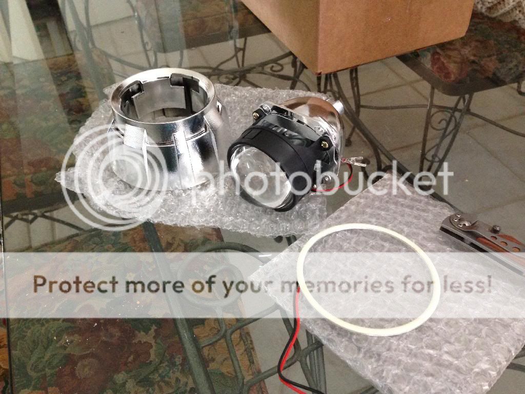

what i ordered from The Retrofit Source- keep in mind some of the links are for a pair of the item when you only need ONE. i just posted links so you could see what you need. TRS can put together a single package for a motorcycle and it will be alot cheaper!
Single morimoto Mini H1 6.0 projector(LHD) part# MH16-LH
(this link is for a pair of projectors, you only need one) Morimoto Mini H1 6.0 Bi-xenon - HID Projectors from The Retrofit Source
Ballast- AMP: Morimoto 3five DSP (35watt) part# 35AMP
(this link is for a pair of ballasts, you only need one) Morimoto 3Five Ballasts (AMP) - HID Ballasts from The Retrofit Source Inc
HID bulb- H1 3five 5000k part# H1-5k
(this link is for a pair of bulbs, you only need one) H1: Morimoto 3Five - HID Bulbs - Components
Gatlin gun shroud part# GAT-P
(this link is for a pair of shrouds, you only need one) Panamera - Projector Shrouds from The Retrofit Source
100mm white LED halo(size depends on shroud you choose) part# LEDRING-100W
(this link is for a pair of LED's, you only need one) Morimoto XB LED Angel Eyes - Accessories from The Retrofit Source Inc
H4: single output motorcycle wiring harness part# CYCLE-H4SINGLE
http://www.theretrofitsource.com/co...-h4-motorcycle-wire-harness.html#.U0LqpPldXEg
Mini H1 Centric Rings (i didnt use the centric ring, or else the shroud prolly would have hit the lens anyways) part# CENTRIC-H1
(this link is for a pair of centric rings, you only need one) http://www.theretrofitsource.com/components/shrouds/shrouds-centric-rings.html#.U0LrKPldXEg

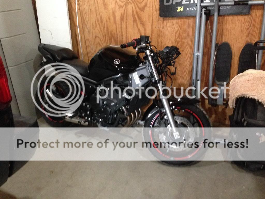

I disassembled the front end of the bike to get the headlight out. took me about 20 minutes to get it all taken apart. Ive had it all out before when i did my flushmounts and turn signals in the front air dams.
street fighter status LOL

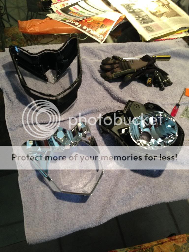

once i got the headlight out, i removed the bulb, bulb retainer, the 3 screws holding in the back, and the 2 little rubber caps on the back of the headlight. I heated the oven up to 250 degrees and put foil on the rack. turned the oven off and put the headlight in for 8 minutes. pulled it out and started working it with a small puddy knife so i didnt hurt the housing. the light came apart first time i heated it up surprisingly. once you get each clip undone i just worked my way around it and it came right apart easily. to be honest this was the part i was nervous about and it seriously was a breeze. the look on my moms face when she seen what i was doing was hilarious. she obviously didnt have faith in me but she said she was more worried about her $5000 oven versus my headlight.

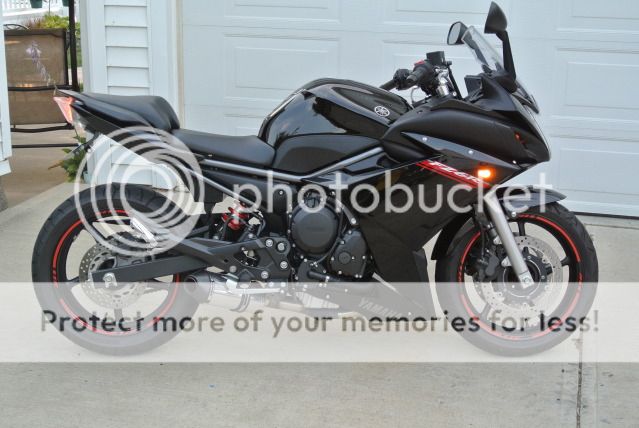

next is to decide on which paint. Im thinking to do the housing and the reflector matte black or gloss black, but for the projector shroud should i leave it chrome, paint it black, or red? or maybe black with where the led shines out of the vents of the shroud do red stripes come out of the vents? what do you guys think? heres a pic of the bike. stay tuned for more progress. chad is ordering everything tomorrow so not sure when i will be able to start test fitting the projector and shroud but i will update you all as i move along. let me know what ya guys think as far as paint color

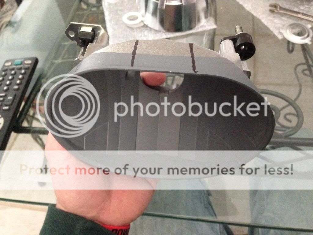

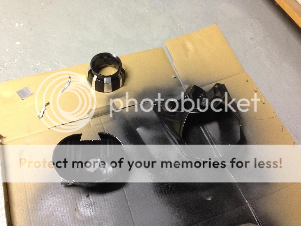

hey everyone. parts from TRS showed up today so i got right to work. was so excited i forgot to eat dinner lol. i had already primed the light as you can see in the second picture but i decided instead of trimming the shroud i was going to trim the reflector housing to keep the shroud whole. I had to still shorten the shroud a little at the bottom but not too bad. got all the holes drilled for the leds to pass through for the led halo behind the shroud. i decided to go all black and leave the details on the shroud chrome since my bike isnt 100% blacked out. got it all mocked up and the primered and painted. the lights are drying now so tomorrow afternoon i will start assembling the light and should have it ready to go tomorrow and have the bike back together this weekend. so far it hasnt been too difficult at all. mine is a little more work than normal because i went with a shroud that was bigger and doesnt fit the housing so thats why i had to do some trimming. alot of trimming, assembling, trimming, assembling....etc to get it to fit the way i want it to.
heres some pics
where i made my first cut and just widened it slowly until it fit
the paint booth lol I used rustoleum flat grey primer(for plastic) and semi-gloss black rustoleum(again, for plastic). for prep work i used sand paper and roughed up all the chrome to give the paint something to adhere too. for those wondering how i painted the shroud i just put blue painters tape over the parts i wanted to stay chrome and when the final coat was dry to the touch i pulled the tape off so that the tape didnt get stuck down after the painted fully cured. the pieces of plastic to the left are the square piece I cut out of the housing and the two slivers of plastic are what i trimmed off the bottom of the shroud. i used a dremel tool with a cut off wheel for all my cutting and a sanding bit to clean everything up.
