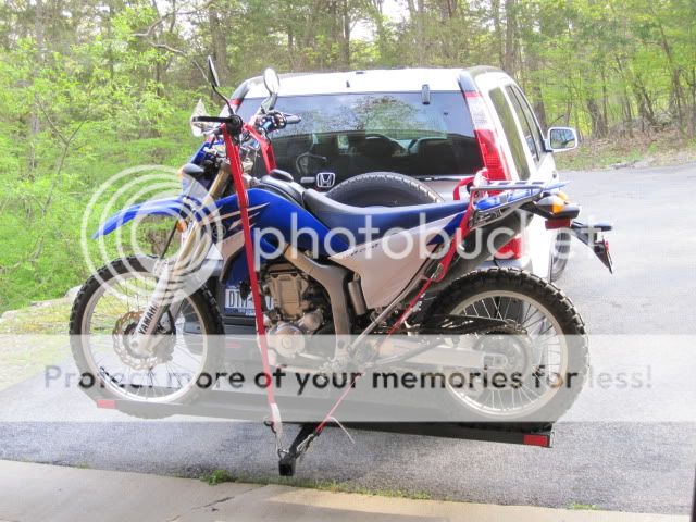

Has anyone ever had to trailer there bike and if so has anyone used the trailer hitch rack for transportation.
I know they say they are built for the weight but I dont know about hanging that with my bike off my *** end??? I think im just going to add a trailer hitch to my car and haul bike with my small trailer down the NYS thruway.......
but Im just wondering if other people have ever used one and wondered. rubber side down baby!!

You need to be very selective in receiver choices as not all class 3 receivers are rated for the same load or tongue weight. In each class, 3, 4, and 5 there are different load carrying abilities. Be sure to verify exactly what have so nothing bad happens.
The minimum is a class 3 with weight distribution and that gets you 600lbs...
I have a 600 Lb. carrier with a class 4 receiver rated at 500 lbs. tongue load. That's based on a ball mount that puts the load just a few inches behind the receiver. Using a hitch carrier with a tube that puts the center of the load 16 inches or so further back is a no-no to my way of thinking when the bike weighs almost 500 lbs.
I do use the setup for my 300 Lb. WR250R, and I feel it's safe.
