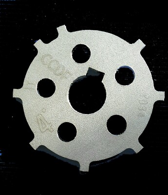

Adding more timing is well worth doing , they pulled heaps out compared to the R6 and FZ6
