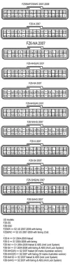

If someone with a U.S 2012/13 bike could take some pics of the ecu wiring loom, that would help me out as the pdf I have lists different wiring colors to what I have. Pics showing both sides of the ecu while plugged in would be good.
Rumpig, one thing I saw in reference to ECU pin out on the "FZ6" is that some EU models had the coil and injector wires swapped vs US versions. No idea if this holds true on your "R" model.

Final Impact, thanks for the pin outs.
