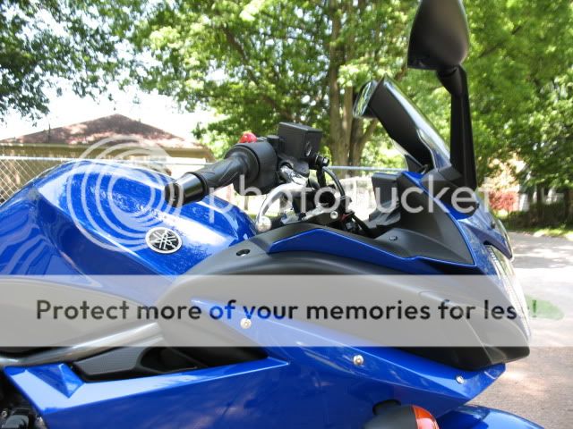

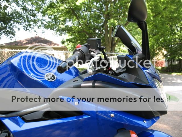

all right... here's a side by side of the before and after. These are the final positions in each location that felt the most comfortable to me. Stock I had them rolled down a bit... Forward they are even rolled a bit more. I do believe I took the second pic before I adjusted my levers.
Use the tuning forks medallion as a reference and you can see the difference:
So I'm clear the first pick above is before it was moved forward and the one below was moved foward? I guess maybe the dealer had the arrow in the wrong direction because it was already pointed towards the front of the bike. So it's moved foward when the angle is in the front towards the windshield rather than closer to the tank/rider?
first pic is the before
I think most dealerships put the arrows on the clamps pointing forward just out of pure ignorance.
if you look at your risers from the side you'll see that the handlebars aren't centered and the risers look to have a bit of a bulge, for lack of a better term. Stock, the bulge is to the back closer to the rider, to move to the forward position you just loosen the risers from underneath, remove the clamps and spin the risers 180 degrees, takes no time at all.
Thanks for posting the pix :). Definitely gives us a better idea of what the differences are- which from what I can see is a subtle difference. I'll prolly consider it once I'm no longer a newbie- whenever that is.
Thanks again :)
You're welcome... and you're right, it is subtle.... nothing life-changing but worth it for me.
