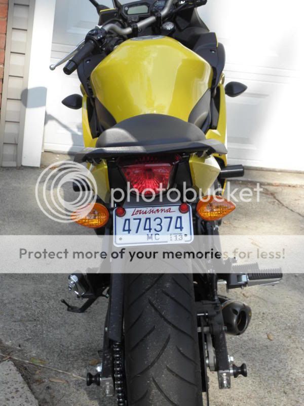

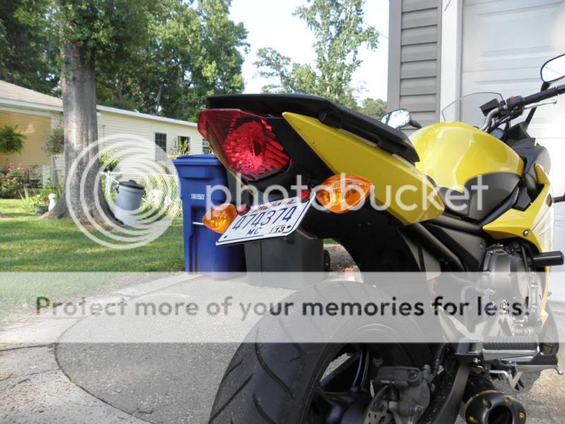

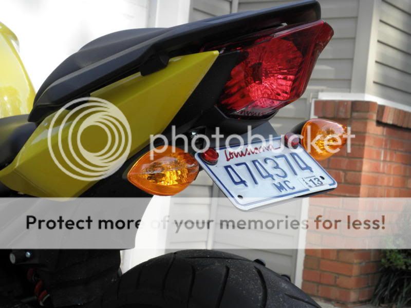

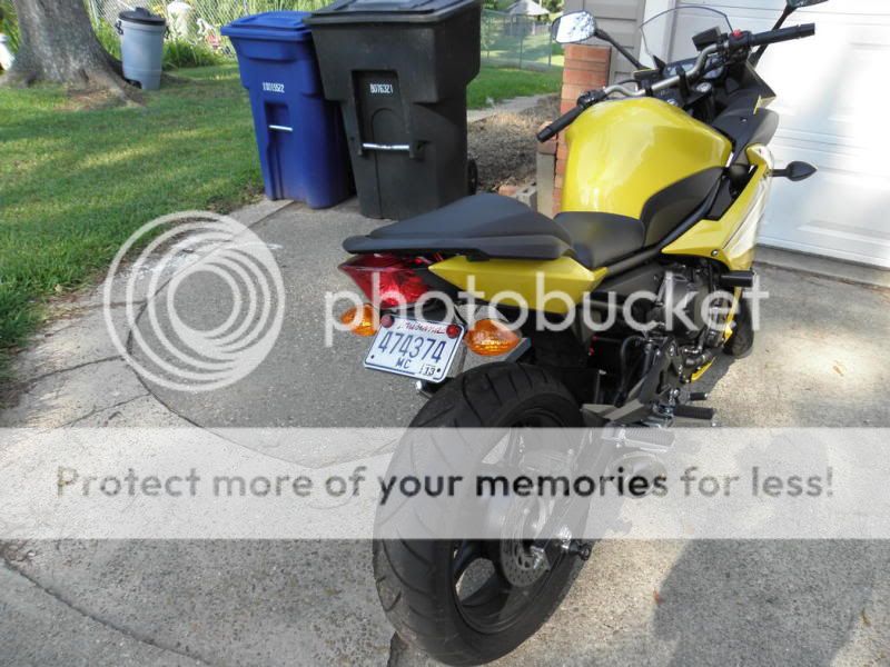

Here are some pictures of his handy work. :thumbup:
