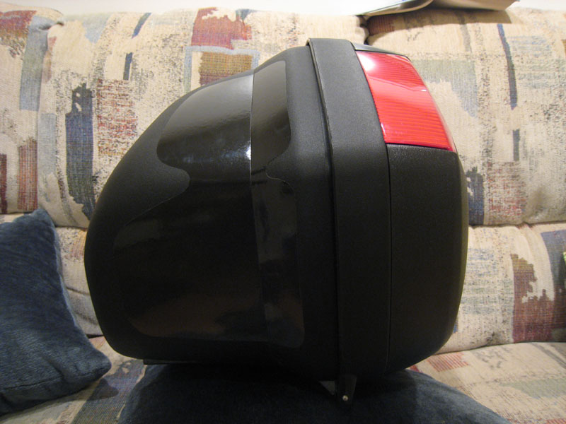

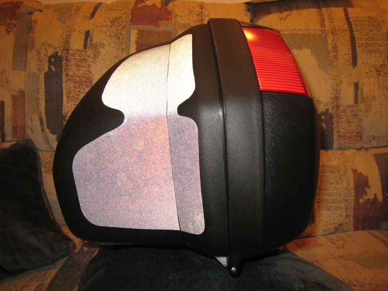

I added some 3M Scotchlite reflective tape to the back of the Givi V35 cases for improved night-time visibility. I spent some time mocking up shapes with some paper until I came up with something that would lay flat without wrinkles, then traced it onto the back of a 12"x24" piece of adhesive-backed Scotchlite (got it on ebay for about $20 shipped). I had about a 12"x12" piece plus some misc scraps leftover when I was done.

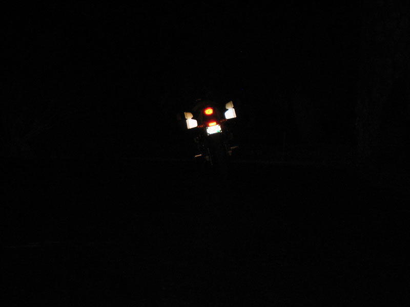

Without flash:
With flash:
Each case has 2 separate pieces that I almost got to meet together perfectly.

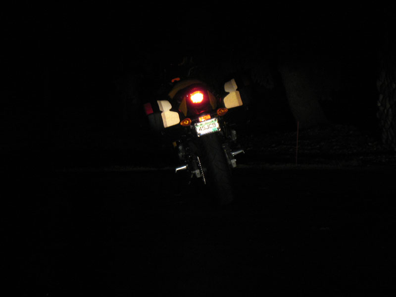

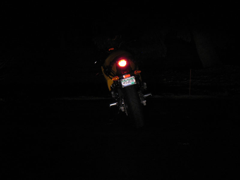

Here's photos of the bike at night with car headlights shining on it (no flash) without and with the cases on:
