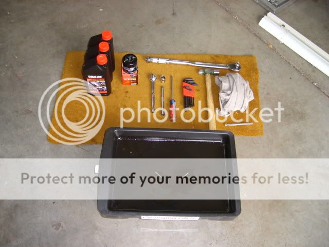

What you need:
Oil Drain Pan
(3) Quarts of Oil (I used Yamalube 10w40)
(1) Oil Filter (I used K&N for easy removal)
17mm Ratchet/Socket (or wrench)
Allen Key Set (I think all I used was the 5mm to remove the fairing)
Optional:
Torque Wrench
Clean Up Rags
Magnetic pen to find drain bolt when you drop it in the oil lol
Oil filter wrench (I dont have one, I used the hammer and screwdriver technique)

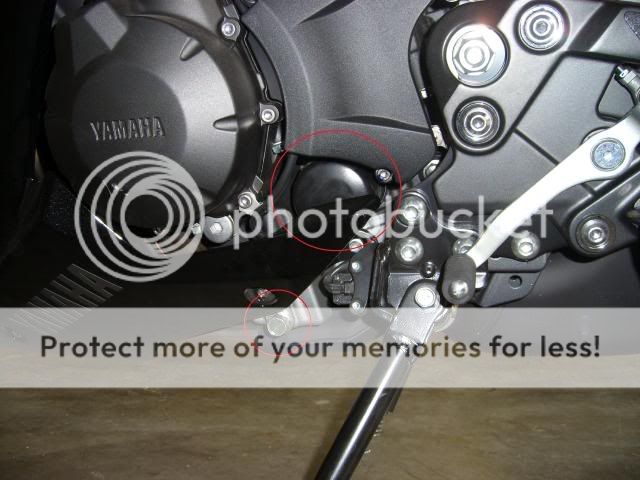

Step 1 - Warm Engine, I went for a 5 mile ride, then let it sit for 5 minutes

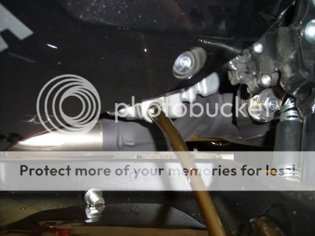

Step 2 - Take your 17mm ratchet/socket and remove the oil drain bolt, mine was a PITA and I could get it to budge so I used a hammer on it. (I plan on replacing the drain bolt ever other oil change just because its a key point and its so cheap)
Step 3 - Let the oil drain, once the bolt came out I went away for 5 minutes while it drained

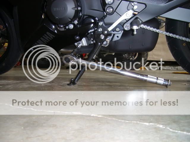

Step 4 - Clean and reinstall oil drain plug, tighten to 31 fl/lbs if you have a torque wrench.

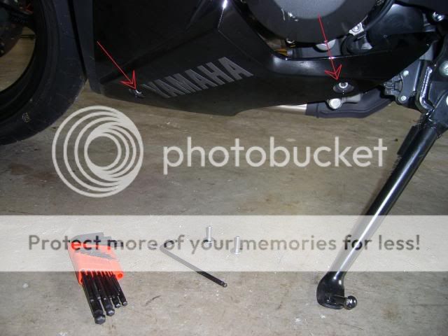

Step 5 - Remove these two bolts in the lower fairing, the manual says to remove the entire piece, but it was not necessary.
