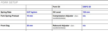

I assume you're using the oil weight provided by RaceTech? If you haven't used the code on your gold valve emulators go do it. You'll get a great print out telling you the exact config you should use. Here's a snippet from mine.

I ended up rebuilding with seals and dust cover while adding the gold valve emulators. The forks seem more planted now on the road. Nothing mind blowing but definitely a noticeable change. I went with a 20wt. oil as race tech suggested and drilled the damper tubes as per instructions. It was worth the money to me.
