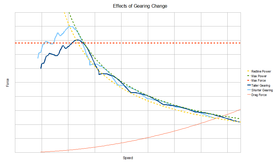

What are the effects of changing the overall gearing of a bike (or any vehicle, for that matter)? The common misconception is that taller gearing gives you higher top speed, but less acceleration, while shorter gearing gives you more acceleration, but a lower top speed. Those generalizations have partial truths to them, but people seem to misinterpret the idea to mean "shorter gearing means that I can accelerate faster across the board!"
Time for some visual aid:
Exact values are intentionally left off this chart to avoid focusing on unimportant details. Before anyone asks: NO! this is not Gen I gearing vs Gen II gearing. This is just two different arbitrarily different gear ratios for illustrating the trends in taller vs shorter gearing.
Explanation of the parts of this chart:
The two jagged mountain lines represent the amount of force applied by the rear wheel at full throttle when in the best possible gear for max acceleration at any given speed. One line represents tall gearing, and the other is short gearing. The gear shifts are pretty easy to spot - they're the creases in the lines.
The "Max Power" dashed line shows how much force the rear wheel would apply if max power was available at all speeds. This is essentially what a CVT (continuously variable transmission) could do.
The "Redline Power" dashed line shows how much force the rear wheel would apply if the engine was running at maximum RPMs at all speeds.
The "Drag Force" line shows how much rearward force is applied by aerodynamic drag at all speeds.
The "Max Force" dashed line represents the most most rear wheel force that can be practically applied to the road. This could be the point at which the bike starts to wheelie, or the back tire loses traction and starts making smoke. Either way, if you see the rear wheel force line go above this "Max Force", you would need to use less than 100% throttle at that point to keep the wheel force at/below the max.
Analysis of the chart:
Acceleration is directly proportional to rear wheel force minus the drag force. Top speed is determined by where the two lines intersect.
I hereby declare that the "Power Corridor" is the space between the "Max Power" line and the "Redline Power" line.
Ideally, once you reach peak power in 1st gear, the rear wheel force should never fall outside of this "Power Corridor". On the FJR, 1st and 2nd gear are too far apart from each other, so they don't actually intersect, and the RPMs fall back too far when shifting into 2nd to stay in the "Power Corridor".
No matter what you do to the overall gearing, the rear wheel force will always follow the "Power Corridor" (except for the beginning of 1st gear, which will always be outside of the corridor). Shorter gearing "squishes" the entire tire force line left and up within the corridor, and taller gearing "stretches" it right and down within the corridor.
Adding more gears to the transmission would allow you to "tighten up" the rear wheel force line so that it stays closer to the "Max Power" line, rather than bouncing back and forth so much.
Shorter gearing can improve acceleration in first gear to a certain point. Anything that goes above the "Max Force" line is useless and just makes the bike harder to ride.
Shorter gearing does NOT improve acceleration everywhere. After 1st gear, it just causes the peaks and valleys of the wheel force line to move around within the power corridor. In some areas you'll have more acceleration with shorter gearing, but in other areas you will have less acceleration.
Taller gearing will only give you more top speed if the original gearing had peak power in top gear occurring before top speed. Go too tall, and you'll start decreasing your top speed. Best possible top speed is achieved when the bike is geared to have peak power at the speed where "Drag Force" and "Max Power" intersect.
Gearing changes alone cannot give significant top speed increases, unless the bike was geared incredibly so low that it reaches max RPM before "running into" the drag force line. If a bike is already limited in top speed by drag, then the only way to significantly increase top speed is to reduce drag (improve aerodynamics) and/or increase power. The amount of power required to overcome drag is proportional to the cube of speed. This means that doubling the top speed would require 8 times the power!
