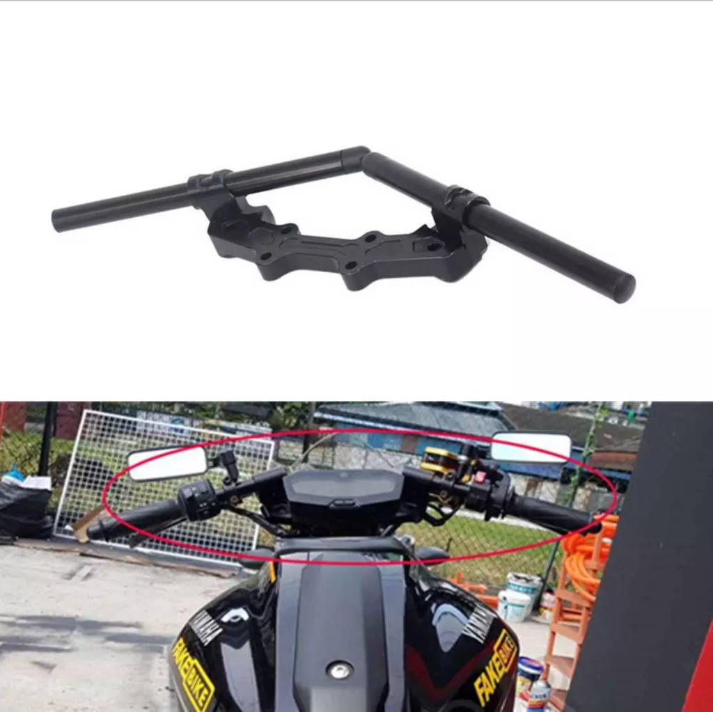

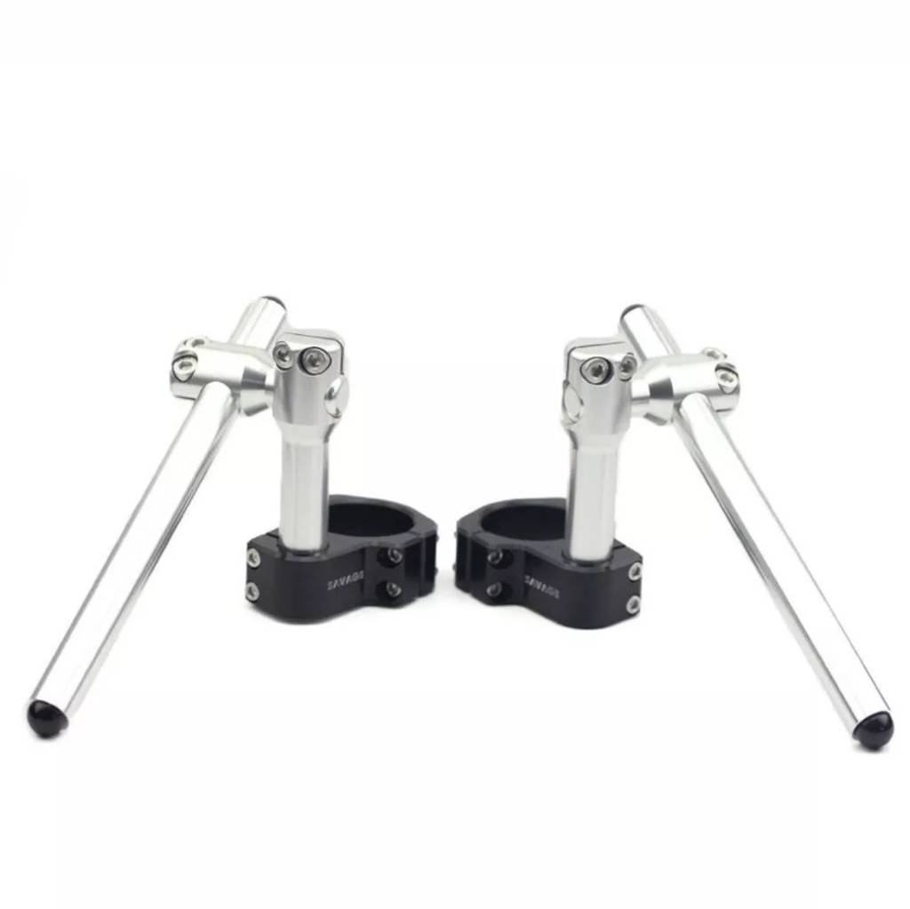

Unfortunately i can't imagine you'll be as comfy as the f4i with the clip ons. The issue is that the tank on the fz6r tank is tall. I have a 06 cbr1000rr and the tank on it is 2.5 inches lower.. Which makes the fz6r a bit of a pain to tuck for long periods without discomfort. Unless you wanna sit on the passenger seat which would put you level with the tank! Lol There are clip ons that don't lower the front though. The adapter plate style that goes on top of the risers. Then there's the clamp style that can go underneath the triple tree with risers themselves. Those kinda look meh to me.. My bike was lowered when I got it. I didn't really like the way it handled. So I brought it back up to stock height and it felt much better (to me). Depsite tip toeing now. I'm only 5"5' so can't give you a great perspective. I just know I ride the FZ6R daily and it's comfy the way it is. I can't daily my CBR. Traffic's a killer when you lean up and down constantly.
